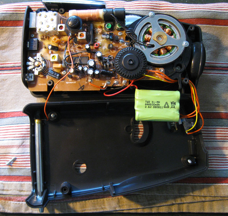

Freeplay Eyemax WB 2009: By far the best of them all. Super beefy crank/generator and the solar cell actually performs. More rugged/durable construction compared to the others. Has 3 internal AAA NiMH cells. Costs a little more ($45) but well worth it. As with the Sangean, the generator is brushless. If you look at the photos below you'll see the generator is much bigger than the Sangean.
Here are photos of the Sangean MMR-77 (after I replaced the incandescent light with a LED): File:Mmr77front.jpg
Here are photos of the Freeplay Eyemax WB 2009: File:Eyemax_wb2009outside.jpg
