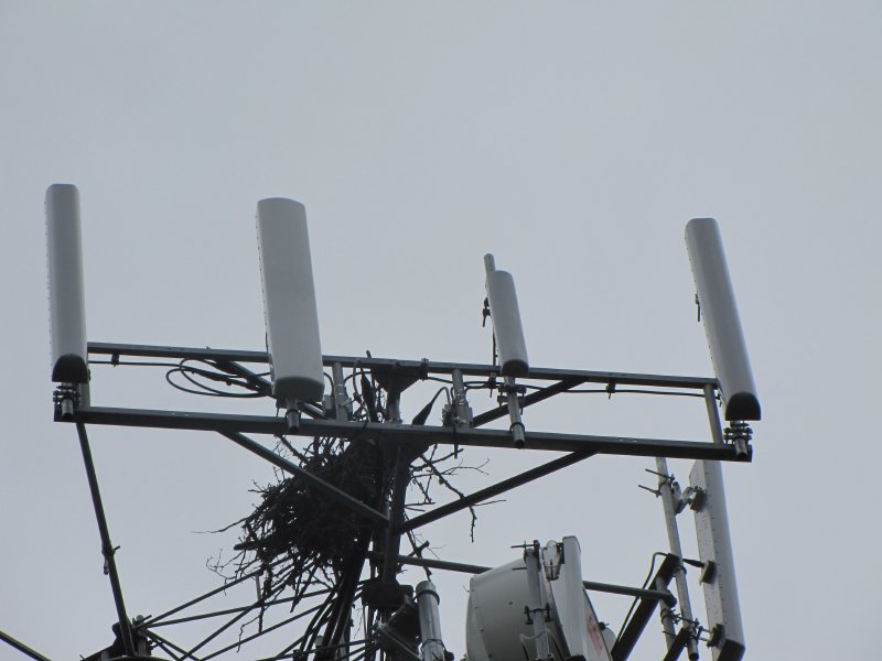

In doing some site inspections today I paid a little attention to some local Verizon cell sites... These are from two different sites...
This shows the two 850 panels on the ends, and the 1900 (3G) and 700 (4G) panels on the inside... And whats left of the obligatory osprey nest...

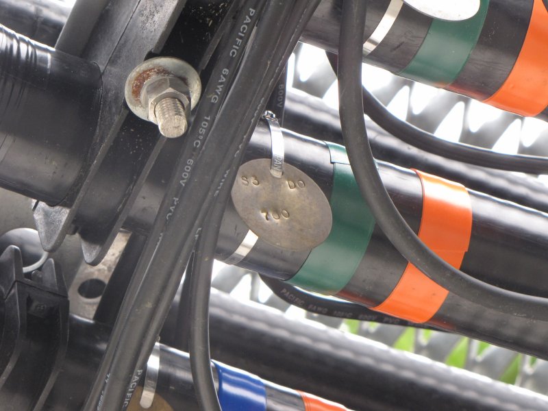

Heliax marked...

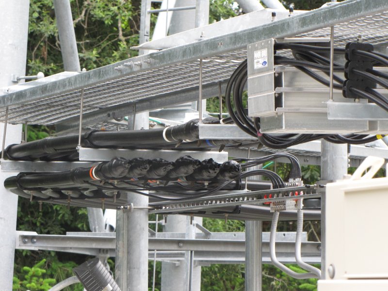

And ready to get connected to the yet to be installed outdoor cabinets (on this particular site)...

So why are they marking the Heliax cable? Just for security/theft/insurance purposes?

Color / tag markings are for identification, to support initial installation and ongoing service.
The imprinted markings that appear more and more on wire jackets are for theft identification.
Which of course does little good when thieving thugs burn the insulation off before selling the copper...

As if any installer bothers to record the manufacturers lot numbers off of the coax... Maybe that's a commissioning requirement now, along with PIM testing??? There are feet/meter markings, but these need to be checked with a tape measure in case of a "printing error" as I discovered "the hard way" that a batch of Eupen cable had been marked incorrectly... but they sent us a reel for free as compensation :mrgreen:
Did a cable replacement (poorly sealed connector at bottom of run sucked enough water to fill the center conductor with around a gallon of water and thus saturated the foam dielectric for around 20 feet) and discovered to our horror that the line in question had different labeling at the top from the bottom. So retraced and relabeled everything in addition to changing out the wet run.
Interesting place for the ground bar :shock: :roll: ... The photo makes the ground tails appear to be radiused a bit too tight for my (and a good number of cell tech's) liking... and the zinc-plated (as opposed to SS or hot-dipped) flat washer is a no-no :shock: :shock: :shock: At least the connectors on the new runs were properly sealed :idea:
