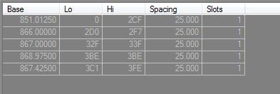

PostPosted: Sun Dec 04, 2016 9:00 am
Set up Unitrunker and you'll have the answers you need in 15 seconds flat.
