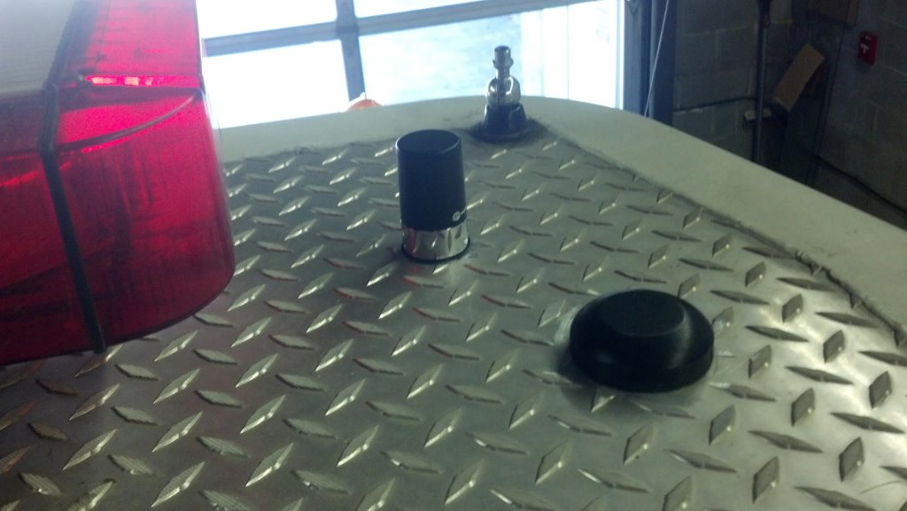

PostPosted: Sun Oct 19, 2014 2:21 pm
Joined: Fri Nov 22, 2013 5:46 pm
Posts: 18
This is a picture of one of the recent installs. Motorola specifications for the GPS antenna is that it be 3 feet from any transmitting antenna and on a metal roof. Motorola model HAG4000-HAG4003. All their vehicles I have seen so far are too close.
Ive also been told the new radios are setting off the sirens on some of the trucks when keyed.
They have also failed to install gaskets on any of the VHF antennas. The FD has already been finding water infiltration on the new antennas. Just seems like they are building expensive callbacks into the installs.

Posts: 96
I've heard from a guy at West Pierce that the installs have been less than ideal as well....
