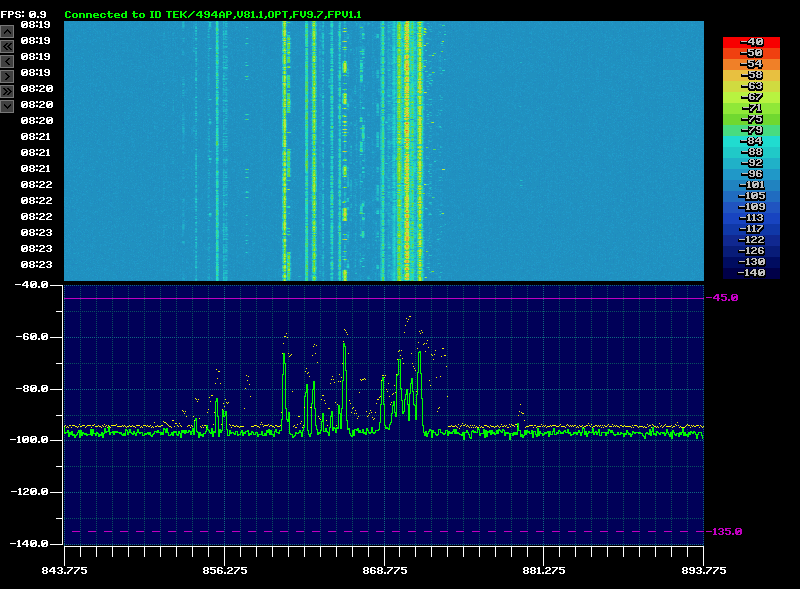

Just curious, does anyone know what the strong, relatively constant digital carriers near the right side of this waterfall plot are? Roughly 869.900 to 871.900 MHz, a couple hundred kHz wide. Antenna location is Lake Forest Park.
Seems that a lot of crud has appeared fairly recently in this part of the band, causing some grief to one of my receivers.

Just curious, what tools/apps are you using to measure RF and obtain that display?

Not sure who the A-side cell carrier is up there but it might be GSM data. Its probably not Verizon CDMA/EVDO as they run it fixed at 1.23mhz bandwidth.

Yeah, I wondered about some kind of Nextel implementation but the signals are pretty wideband, for voice comms. Was thinking it might be a wireless network for mobile laptops in police cruisers, or some such.
It's a Tektronix 494AP spectrum analyzer running my homebrew waterfall display app through a Prologix GPIB-LAN adapter. The monitor program is actually running on the PC in my office in Kirkland, while the analyzer's at home in LFP.

Keep in mind 869.040 - 893.970 is cellular so its definitely not Nextel.
869-880 is the "A" block of cellular frequencies.
It appears Cingular/ATT is the A-side licensee for the Seattle area:
http://wireless2.fcc.gov/UlsApp/UlsSearch/license.jsp?licKey=11941
...and they are definitely a GSM carrier.

Sounds like that's it, Rich, thanks for the clue! Hosed by my own phone company. Figures...
