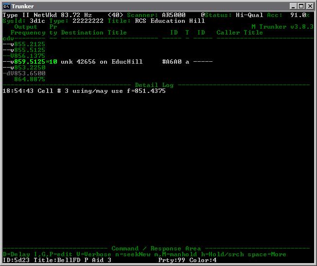

FlashP wrote:
Education Hill has gone: 853.6500 & 853.9000.
What's with the weird talkgroup on channel 154(hex)? Testing?
It's still doing that, fairly often:
I confirmed that there really isn't anything transmitted on 859.51. (Yes, the last freq is bogus, I hadn't overridden the default with the rebanded value.)

Flash P were you able to make classic trunker work with rebanding? If so how did you go about it? I'm trying to use it on KC simulcast 853.425 but of course the frequencies are not correct.
Thanks.
Vince.
PostPosted: Tue Jan 05, 2016 6:45 am
Posts: 830
Trunker works fine, it's set to handle new bandplans by ignoring them. Let it build the frequency list, then type over the "wrong" values with the correct ones - that gives it the lookup for channel number to frequency.
