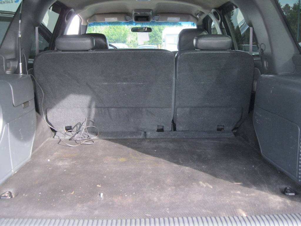

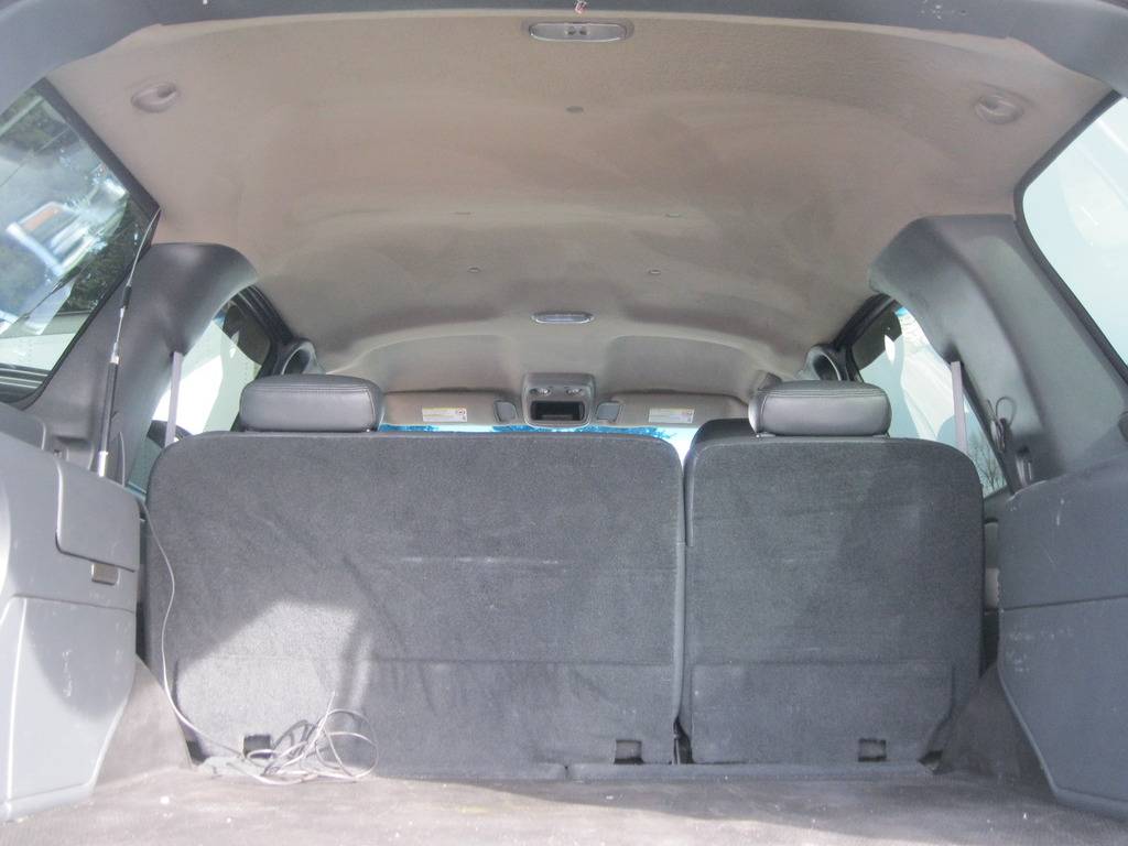

Seriously...
Pacific County, BTW....
One of their unmarked Tahoes....
I've installed some low pro NMO UHF and 800 antennas on rear decks of CVPIs, but seriously? The antenna is probably grounded to the damn body with the whip stuck up there...

Is that wad of cable the feeder for the antenna? I have done temporary installs with more care... Surprised the top whip wasn't simply "bent to fit"... Seen that a time or two. For obvious RF safety and propagation issues I have a really big problem with installing antennas inside the occupied portion of a motor vehicle in the first place when there are really cool methods of effectively transmitting and receiving the RF "outside the box" without the "antenna" being visible. You know, cavity slots hidden in luggage racks... DDRR's, etc... Those "unmarked" SUV's used by "agencies of the state" need a bit of the "redneck" treatment to make them "plausible" as anything BUT the typical (insert agency here) "unmarked" SUV...
Had a spotlight too..
I LOLd...
Like I said, I've installed 1/4 waves for 800 and UHF/UHF-T on rear decks of SAP CVPIs, and Wimpalas, but these were 15W and 25w radios (respectively), on systems with 90% coverage for 3W and 5W portables.
improper grounding, improper groundplane, poor RF radiation pattern, higher RF exposure, SWR must be through the roof, etc.
Reminds me of the agencies that used their fleet mechanics to install lighting/communications.......
I'm having flashbacks to wire nuts and telephone cord used to wire stuff in, and... stuff like this.... :shiver:

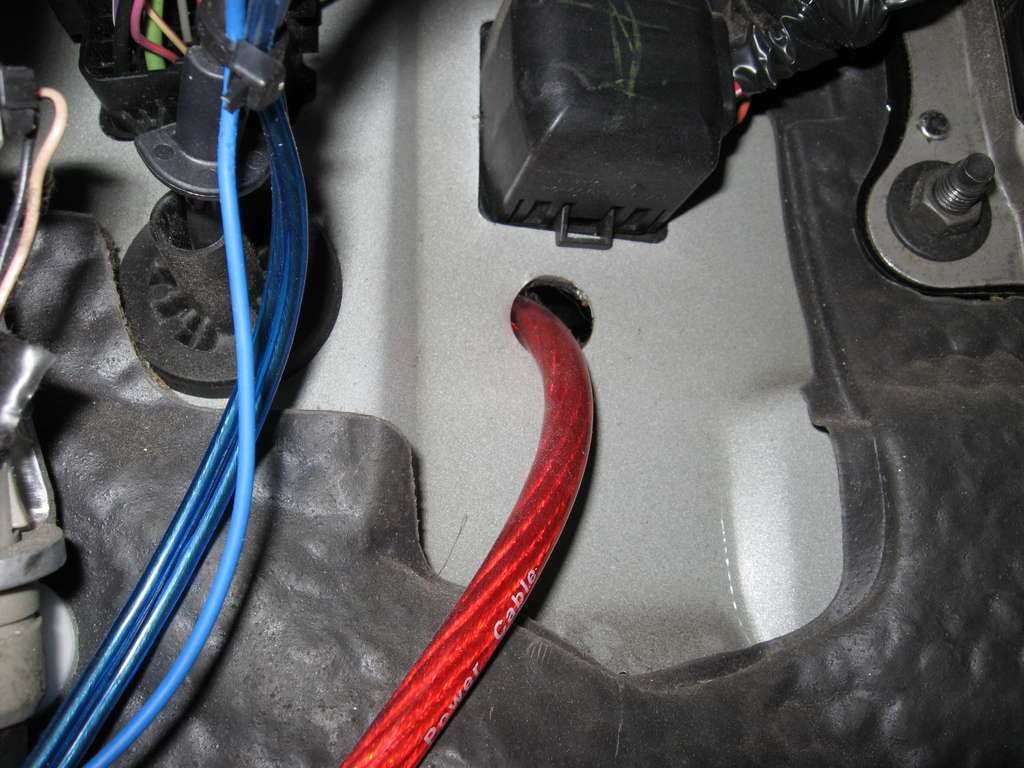

PostPosted: Fri Mar 20, 2015 9:42 am
Grommet! What's a grommet? ;)

Grommet??? What's Thaaaat??? (Expletives, several, come to mind) Let us say for the sake of "argument" that, after tearing the whole shop apart one was unable to locate a "proper" grommet but still wanted to prevent a significant electrical fire one might... MIGHT... consider several layers of electrical tape around the wire, sufficient to prevent movement of the wire in the hole?????? Falls into the category of "doing SOMETHING even if it's wrong"... and a few cents spent on the electrical tape and the time to install it preventing the destruction of a new vehicle? Priceless ;)
1/4" split loom. Works wonders in a pinch. Run it around the edge of the hole, creates its own grommet.... the wire gets put in split loom. Plastic on plastic, should anything vibrate/move (should be secured/tied anyway), instead of sharp metal vs cheap rubber/plastic sheath...

And in the absence of "split loom", and doing this in the "fleet mechanic" shop, rubber fuel line hose, sliced lengthwise would "gitter done"... If passing a large wire through a large enough hole, then a chunk of dead coolant hose could be similarly sliced lengthwise, slipped over the wire, ziptied or electrical taped into place, and together with the fuel line on the sheetmetal, you got wire protection as good if not better than a factory wire pass-through, for next to no money in material and but a few minutes with a sharp knife to create. A squidge of RTV gasket maker on the engine side and it becomes moisture/gas tight!!!
Contrary to rumors to the contrary, "this ain't rocket science" ;)
