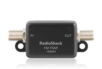

About two weeks ago I connected my discone antenna up to my RS PRO-197 scanner.
I noticed a fair improvement on UHF but on VHF the s-meter was always pegged and I found after a frequency on VHF was received that the squelch would stay open and could not be adjusted to have any effect.
By adding attenuation on each VHF frequency that problem was somewhat less. But what a pain. I could only receive one NOAA weather channel.
Did some research and found that adding a FM trap in line with the antenna coax that now the s-meter was no longer showing an indication when no signal was present. Now I can run all VHF frequencies with no attenuation switched on. I can now receive 4 NOAA weather channels. There is very little degrading of the signal strength on AIR/UHF/800 bands with the trap in line.
If you are having problems with overloading it is worth trying the FM trap. It was very cheap and sure works great for me.

Jim, it's a cheap solution but not sure how effective it will be in the long run. The idea of how this works is that inductor coils notch out a portion of the FM broadcast band. The generated insertion loss is an attenuation of RF signal. So in effect you really did just add an attenuator to your antenna.
Like me, you're probably picking up a lot of paging interference which is creating the intermod you hear. (It doesn't help that most handheld scanners were meant for use on rubber duck antennas either!)
My location in SE Bellevue is a magnet for RF. All of my external antennas have to use proper filters or I'd be in a world of hurt. The paging interference is incredibly high here. I use a PAR filter VHF TN152-158... it's pricey but well worth the cost.

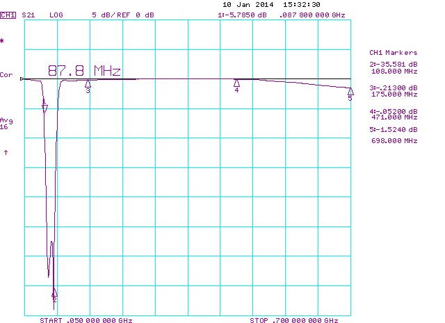

For $4.99 it works pretty well. I can receive WSP from Bremerton and Island County Sheriff here in Bellingham.
There are a couple of FM transmitters located about 1/2 mile away from me on my hill so that is probably why it works so well for me.

That PAR pager trap looks like it attenuates over 10dB from 150 to 160 MHz! Most of the VHF High band less 2 meters.
The RS FM trap attenuates about 4.5dB above and below the FM band.

That PAR pager trap looks like it attenuates over 10dB from 150 to 160 MHz! Most of the VHF High band less 2 meters. The RS FM trap attenuates about 4.5dB above and below the FM band.
Yes, it's doing its job. It's knocking down those pager frequencies.
10dB isn't exactly a lot of signal. When you're getting interference, this is about 1.5 s-units. For an external antenna, this is negligible.
The FM trap is OK but you're not even getting a s-unit of reduction. I'm surprised it's making that much of a difference. If you have heavy WFM interference then a s-unit isn't that much of a reduction...

The FM trap rejection is -6dB @ 89MHz & -20dB between 100 & 108 MHz.
Loss between 5 & 87 MHz is -5dB and between 125 & 890 MHz is -4.5 dB.
As per the back of the pack it came in.

Ah okay sorry I misread that then... -20db should be respectable.
