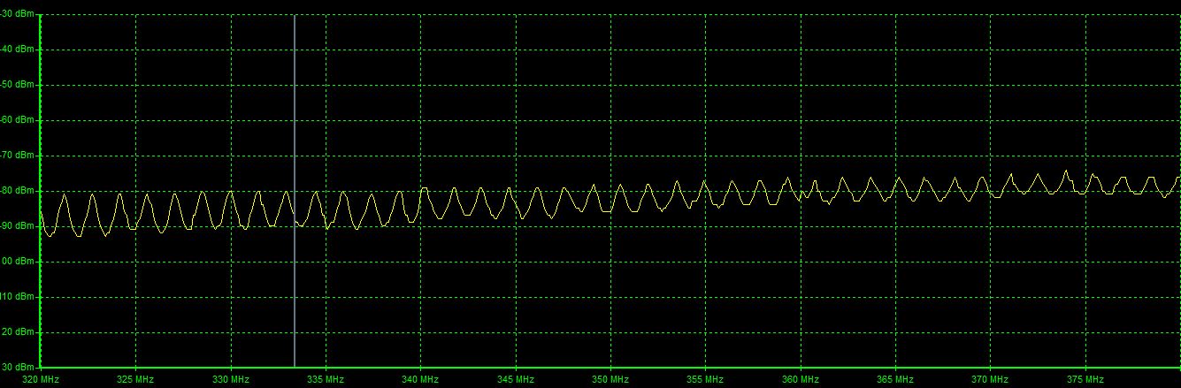

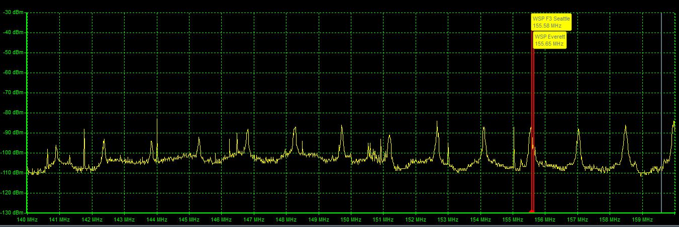

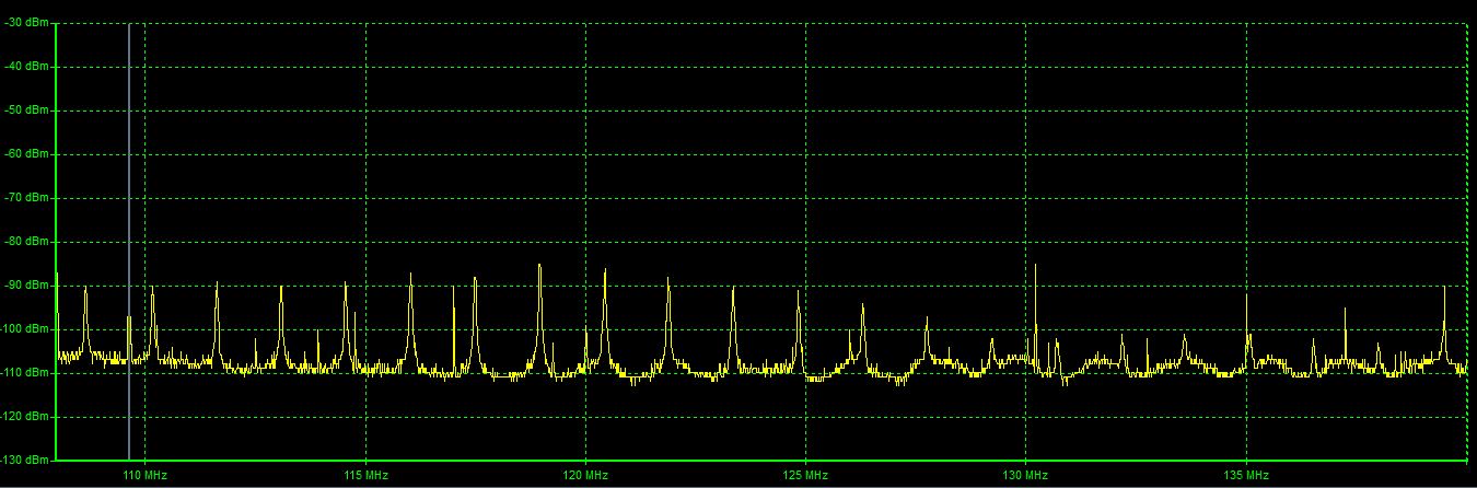

I have a very RF noisy car.
it's a 2000 Honda Odyssey.
How do I quiet it down?
it transmits spikes all across the RF spectrum from 50Mhz to 450Mhz. It spits out noise that is 20dBm above the noise floor. The interference is in the shape of 200KHz wide spikes about every 1.5MHz all across (seamlessly!) the spectrum. And for fun all the spikes SWEEP down the spectrum at a rate of about 1MHz every second.
So if you are listening to something, it will go quiet for a second as it get's fully blanket by the dead carrier of the car, and then it comes back as the spike moves down the frequency, only to be fully blanketed again with in about 2 seconds by the next spike crawling down the frequencies.
This happens at all RPMs when the car is running. AND 15 seconds after the car is turned off. So I'm guessing it's the ECU.
How do I quiet this car down?
3 files is the maximum attachable below,
So here's a sample of:
320-380MHz
140-160MHz
108-140MHz

Are you running your scanner on the car 12 volt system?
Does it still occur if you run a portable not hooked to this system?
From the samples it looks like it would happen on a portable also.
Do you have any other items in the car that run off the 12 volt system?
Does it occur with the ignition switched on and the car not running?
Sounds like the ECU is probably the cause.
Found this by googling.
http://www.amalgamate2000.com/radio-hob ... erence.htm
Good luck and let us know what you find out.
