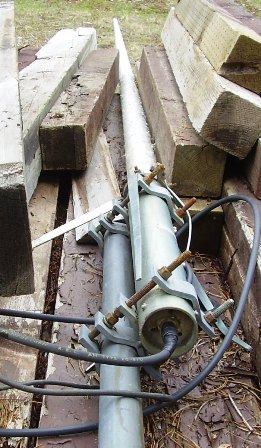

I've got this I'm thinking about using for the scanner (RX only):
(Poor photo, Motorola, about 16-20 feet tall, says 168mhz on it. Should have some gain.)

Steel & 6/12 pitch.
Oh- so a big ground plane! :mrgreen:
I did a mobile mount on a steel roof one time just to get em back on the air... Building was going away soon so didn't even ask about drilling the hole. Coverage was down a bit but it worked... Antenna actually duplexed quite well...
