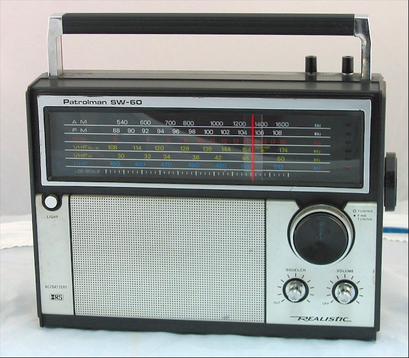

The hobby has gotten to a place that the radios are smarter than the users. I'm in the exact position...I love my 393T
PostPosted: Fri Jul 08, 2011 8:44 am
Icom1020 also "likes this"
PostPosted: Fri Jul 08, 2011 10:24 am
Funny, a radio like that is what got me started in this hobby, and into a career in LE.
I have one exactly like this one! :D
I did too, it replaced an eariler one which crapped out after a couple of years. I have never loaded a V file. I tried to once and would rather replace a head gasket.
