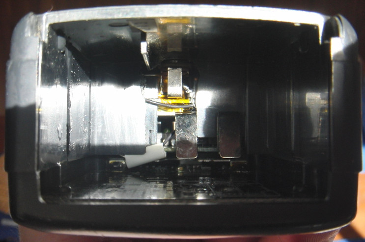

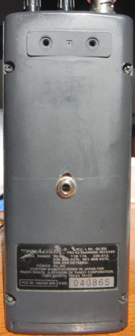

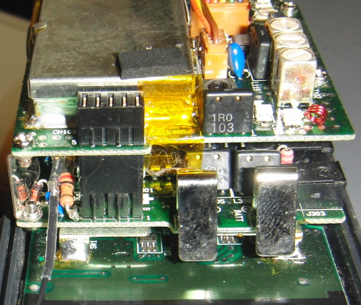

Here is another project I finished.
Happy to say that the d-tap helped out the decoding quite a bit.
I was able to squeeze in the audio jack inside the case by cutting some of the case away. It fits where the kapton tap is laid down on the board. It was a very tight fit.
I miscalculated where the hole for mounting the jack needed to be. But, it works fine.

PostPosted: Fri Jul 22, 2011 4:37 pm
Those solder joints don't look too sexy but they'll probably be okay. :wink:
Grats -- glad it works now. What are you monitoring with it -- pager stuff or trunking channels?
PostPosted: Fri Jul 22, 2011 8:32 pm
Posts: 581
Hard to solder in such a small area. But ya, it will work.
I've been using it for FD pager stuff. 152.0075
