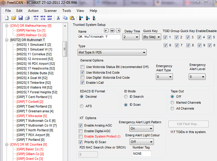

I really appreciate this. All I had was a copy/paste of multnomah county list of talkgroups.
Does this look correct if I just want to listen to police and sheriffs around Portland? I noticed that multnomah co E and mult co W are identical talk groups. ID's are all the same. Is that an error?

Keep in mind the Uniden 396/996/15 scanners can only define circular geographic areas for scanning with a GPS. For countywide talkgroups, to cover the Multnomah County boundaries using only circles it was best to use two partially overlapping circles, one labeled East and one labeled West. If you click on Freescan's map button for each area you'll see what I mean.

Wow, thats werid....yeah, there is no MCSO West or East...its all on MCSO DP...

So now I realize these are all the exact same talkgroups that I already had as far as Portland goes.
Yeah, the sheriffs office is on 122nd on the east side there is no west side office that I know of.
