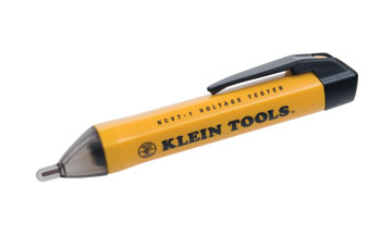

Is it ticking continously while you hold it next to the wire?
Or does it tick a few times when you place it next to, or pull away from, the wire in question?

Its actually one of these... And it stays on continuously when in the vicinity of the antenna wire which is the wire in question...
