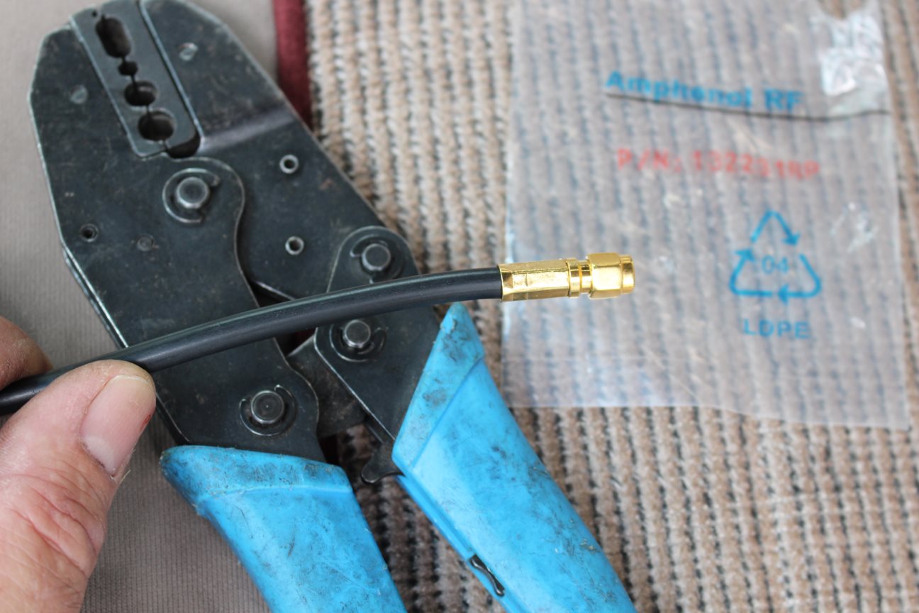

Finally unloaded my camera- Here is the LRM240 and reverse gender SMA connector.

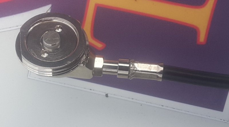

Found some NMO mounts with FME sockets on them. Makes use of LMR240 without soldering and full 100% shielded at the base of the antenna. Only thing I don't like it the nickel center contact. Older mounts we used to have where brass but appear to be out of production. I had one left and put it on my van. (Im selfish like that)
800mhz Customer we did these for can now talk through (rough copy) the repeater in places where the original RG58 install couldn't even tickle the repeater receiver before. Receive on the mobile of coarse is also a pretty dramatic improvement.
But everyone knows it's more profitable to just tell the customer build more repeater sites I guess.

Interesting combination, maybe I will give that a try on the truck. I thought FME's were similar to PL259's when it comes to performance shortcomings on UHF and above. Either way (at 800mhz) you are probably picking up 1-1.5db with the better cable and another 1-1.5db with the correct connection/shielding at the mount base.

Good point- Im not sure myself about FME loss but know the antenna companies tend to use the connector on their cellular offerings so I kinda went by their lead there.. I did one of the installs with an SMA NMO mount so have the ability to test that if I needed to. And now I'm intrigued!

So according to their calculator only 1db.. But almost 20% more efficient.. And with other factors such as going from big button to small button.. 100% shielding like you mention, and I used a Laird B7603 5/8~ antenna to replace the center "curly" coil wire antennas. Just trying to take out the weak links out of the antenna system.
