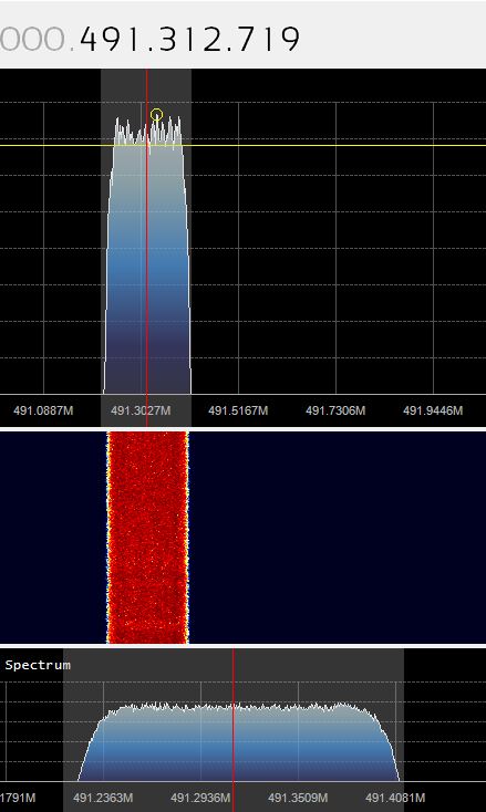

has anyone found a hardware or software that will decode Shure ULX-D digital transmissions?
most of the time they are run un-encrypted.
attached a screen shot of the transmission. it's 200 KHz wide, nice straight sides.

AES 256-bit encryption equipped for secure wireless transmission
Good luck. :)
The audio is using this form of encoding and you would need to find a setup that can decode it:
https://en.wikipedia.org/wiki/Dante_(networking)
FYI, it sounds like the custom Shure application can decode it:
http://www.shure.com/americas/products/ ... orkbench-6

Most of the time the transmission is run un-encrypted because it makes it easier to work with. The Wireless Mic Tech doesn't need to exchange keys to switch between hand held, and lav pack transmitter. If it's un-encrypted you just need to turn off the hand held, and turn on the lav pack.
Dante can only decode the Dante audio network coming out the the back of receiver via RJ45. It is not the codac that the transmitter is using. Dante is a transport protocol out of the receiver and into the sound mixing console.
Shure's Wireless Workbench is similarly handicapped that it can't decode any audio. It's just a remote management software used to set up the radios.
