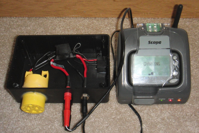

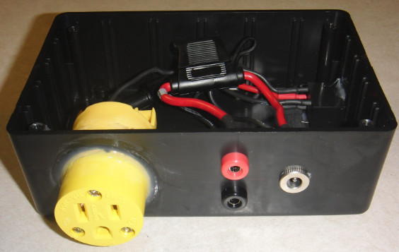

I finally got this project done and wanted to post a small update.
We purchased a couple of Scope pagers with charging stations from http://www.firstresponseactivation.com/
The relay output on the charging dock was the key. However, it was only rated at 28v 2a. So I had to build a box with a relay that when activated would close the 120v connection setting off the whole system. I have attached a couple of pictures.
Valleycom is going to add the new cap codes to our run cards next week.
Many thanks to FireDawg89 for the tip on the Scope pager.
